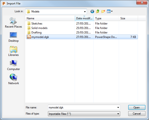

Using the Import option
To import a file:
  1. Select File > Import.
    The Import File dialog is displayed:
  2. Browse to the folder containing the file you want to import.
  3. Select the type of file you want to import in the Files of type list
  4. Enter the File name.
    Note: When importing IGES files, PowerShape uses its own default tolerance values. You can change the defaults on the Options dialog before importing. The new values affect only the current model. Large tolerances produce poor quality surfaces and small tolerances make the application run slowly. You may need to experiment to find the best balance for your models.
  5. Click Open.
    The file is imported and opened.
