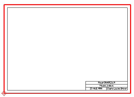

A title block is a block of text containing:
  • Name of the product and its version number
  • Name of the sheet
  • Date
  • Name of the author.
When you create a title block, a border is added around the drawing and the text:
To add a title block:
  1. Ensure the drawing window is open and is the current window.
  2. Click Draft tab > Drawing panel > Titleblock.
You can edit the text and update the title block to the current details by creating the title block again.
