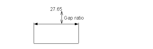

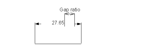

Gap ratio — Edits the gap between the leader and the text:
  • If Horizontal text is set, the gap ratio is as shown below:
  • If Embedded text is set, the gap ratio is:
