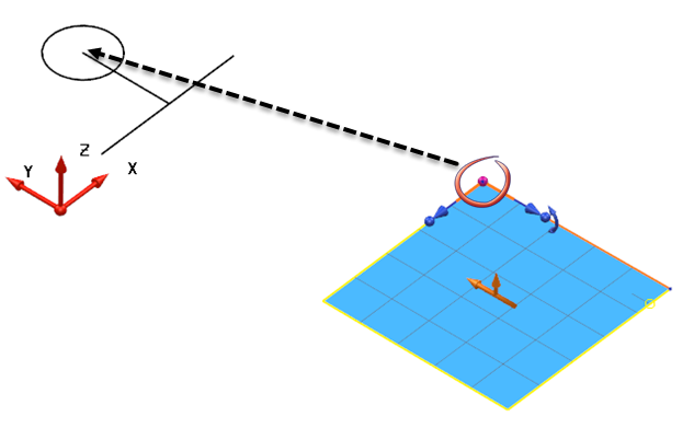

The example below shows a plane with a selected corner, ready to snap to the centre of the circle in the direction shown by the arrow.

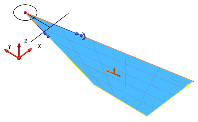

The example below shows the corner point dragged and snapped to the circle centre.

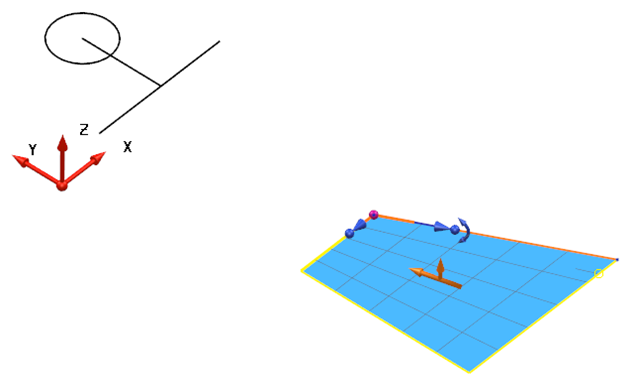

The example below shows the corner point dragged to the circle centre, but using the X key to lock the X axis.
