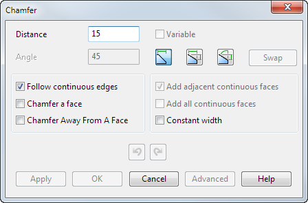

  1. Click Solid tab > Feature panel > Fillet > Chamfer to display the Chamfer dialog:
    If your version 8 solid contains more than 20 surfaces and is not watertight, you are asked if you want to make it watertight. If you click Yes, the Make Watertight Wizard appears to help you make the solid watertight (within tolerance).
  2. Enter the Distance to be used to create the chamfer as shown below:
    Chamfer
    Distance
    Arc with radius equal to distance
  3. Use one of the following options to specify the chamfer:
  4. Select the chamfering route:

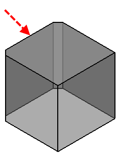

    • Chamfer a face — Select this option and hold the cursor over a valid edge, before a path is selected. A path is highlighted containing all edges of a face of the solid which contains that edge.
      If you select an edge, a new path is selected containing all edges of a face of the solid which contains that edge.
      The edge shown below is selected.
      The following path of face edges is selected.

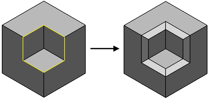

    • Chamfer Away From A Face — Select this option, then select a face on the model to highlight all the edges to be chamfered. The highlighted tracks are chamfered when you click Apply.

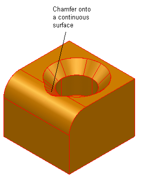

    • Add adjacent continuous faces — Select this option if a chamfer cannot be created because it spreads onto neighbouring surfaces.
      The chamfer does not spread beyond the neighbouring surfaces. To spread the chamfer beyond onto all surfaces, use the Add all continuous faces option.
      This option allows you to create the chamfer onto the continuous surfaces.
    • Add all continuous faces — This is the same as the Add adjacent continuous faces, except the chamfer can spread onto all surfaces that are tangent plane continuous.
