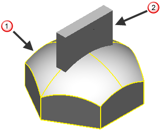

    This example shows an active solid intersected by an inactive solid :
    In this example, the new active solid is given below:
