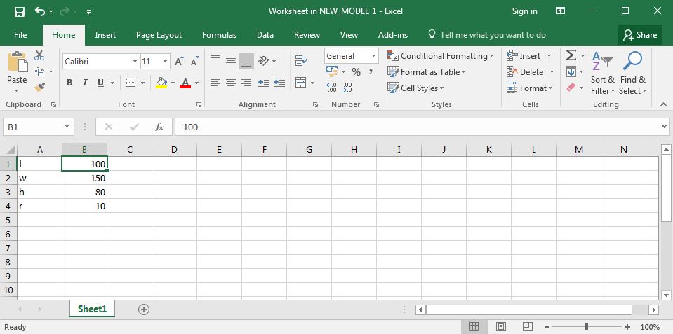

- Enter one column with parameter names and another column with their values.
The example below shows parameter names entered in column A and their values entered in column B.
