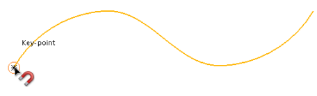

- Click Edit tab > Limit panel > Point to display the
Limit point toolbar:
The cursor icon changes to a magnet and a circle is drawn on the end point or edge to be limited.
- Do one of the following:
- Drag an end of the object to a new position. The end of the object extends or trims to where you release the mouse.
- Click a position on a wireframe object. The object trims back to that position from the nearest end key point.
- Click a curve on a surface. The surface trims back to that curve from its nearest end.
