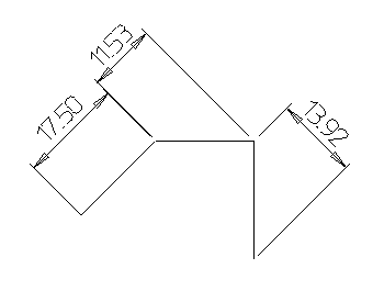

    You can create dimensions projected at any angle.
    To create an angled dimension:

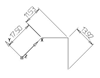

    1. Create the geometry.
    2. Create a workplane.
    3. Position the workplane such that the principal plane is at the angle you wish to project the dimensions.
    4. Create the dimensions.
