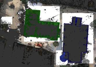

To define a new selection area when other areas are selected, the previous areas are cleared by default. Follow this procedure to add the new selection to selected areas you have already defined.
- Press Shift as you use a Selection tool.
- A + attaches to the drawing arrow.
- Define a new selection area.
- Release Shift when you are through defining the additional area.
Any combination of selection tool boundaries can coexist as a cohesive selection. Scan Regions and Clipping function as normal, regardless of your quantity and variety of selections.
