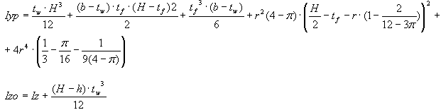

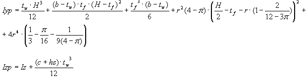

Moments of inertia about Y and Z axes, respectively, of the section made only of flanges:
  • A solid section
  • A section with an opening
Arithmetic average of the moments of inertia of sections weakened and not weakened by openings
Torsional moment of inertia
A solid section
