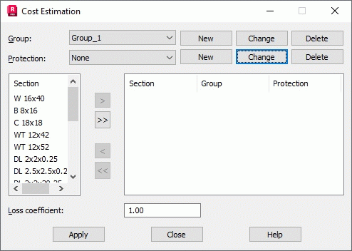

Select Tools > Cost estimate to estimate costs of the designed structure.
To obtain a detailed cost estimate define certain groups of sections. In general, steel sections have different prices, depending on the section type.
- Groups - Contains the list of created section groups
- Protection - Contains the list of created layers protecting against corrosion and chemical impact, or providing the structure with an aesthetic aspect (such as zinc coating, anti-corrosion paint, and varnishing).
To the right of the dialog are sets of buttons for Group parameters and Protection parameters. Each set consists of the following:
- New - Create and define the parameters of a new group (Group parameters) or protection layer (Protection parameters).
- Change - Edit the parameters of a group or protection layer.
- Delete - Delete the group or protection layer.
When defined, ascribe sections to appropriate groups.
- Select a section.
- Select a previously defined group.
- Select a previously defined protection layer.
- Transfer the section to the right-hand panel by means of the following controls.
Adds the section selected in the left-hand panel to the right-hand panel.
Adds all the sections from the left-hand panel to the list of sections in the right-hand panel containing all the element that will be covered by the cost estimate.
Adds the section selected in the right-hand panel to the left-hand panel.
Moves all the sections from the right-hand panel to the left-hand panel.
Ascribing sections to appropriate groups and protection layers ends the process of estimating costs. The cost estimate is available by selecting the View > Tables command from the menu and selecting the Cost estimate option in the Tables - data and results dialog.
