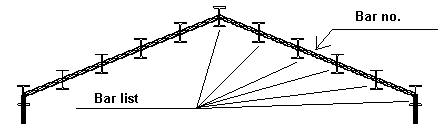

- Select the member (the Position option in the Special values field and the Number option). The selected members are turned in such a manner that one of the cross-section principal axes is perpendicular to the longitudinal axis of the highlighted member. This option is useful when setting roof purlin members. The consecutive stages for determining a Gamma angle for structure roof members are shown in the following images.
Initial position of members |
After defining a Gamma angle, the following members are selected:
Position of the members after defining a Gamma angle. |
