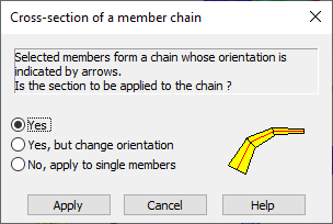

In the dialog, you can define how you want to assign the section to the members. At the top of the dialog, a question displays whether the section is to be applied to the chain of members. There are 3 ways to apply the section:
- Yes (retain orientation) - The variable section is applied to the chain of members and the orientation of the chain represented by arrows (the beginning and end of the chain) are retained.
- Yes, but change orientation - The variable section is applied to the chain of members, but the orientation of the chain represented by arrows (beginning and end of the chain) is changed.
- No, apply to single members - The variable section is applied to a single member in the chain.
Clicking Apply assigns the variable section to the selected members.
