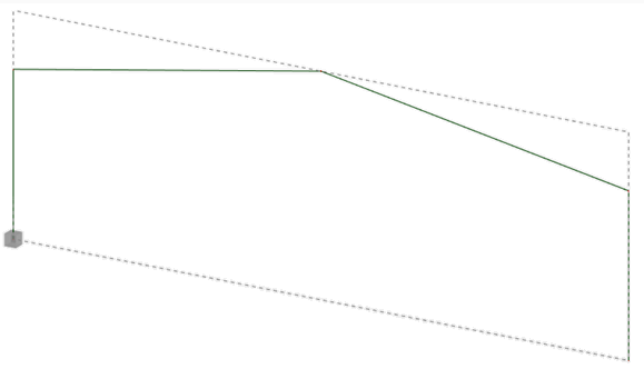

Background of the Advance Steel model
To display the background, select the Create Advance Steel model as backgrounds option in the Integration with Autodesk Advance Steel dialog, before you transfer the model to Robot. Then you can track differences in the model geometry between Advance Steel and Robot.

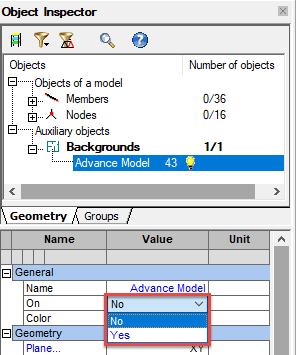

If needed, you can disable the background:
  1. In Robot, in Object Inspector, expand Auxiliary Object and select Backgrounds Advance Model.
  2. In the bottom panel of Object Inspector, under General, in the line On, select No.
