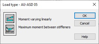

Load Type - AIJ-ASD 05
The dialog box below enables definition of a load pattern for the analyzed beam.
The information about the loading method is used while calculating a value of the coefficient C which depends on the distribution of bending moments along the length of the analyzed member. This coefficient is subsequently used to evaluate the allowable stress for bending with lateral buckling fb according to section 5.1.(4) of the code.
