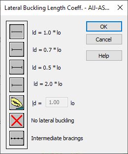

Lateral Buckling Length Coefficient - AIJ-ASD 05
This option is used to define the appropriate distances of member sections protected against torsion, i.e. lateral buckling length. This option is available after pressing one of the following buttons: Upper Flange or Lower Flange in the Lateral Buckling Parameters field of the Member Definition - Parameters dialog box
At the bottom of the dialog box there is the Intermediate bracings option. Pressing the icon, which represents this option, opens the Internal bracings dialog box.
