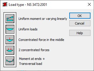

The option is used to define appropriate code parameters of lateral buckling depending on the static scheme of a member. It is available after pressing the relevant icon in the Lateral buckling parameters field in the Member definition - parameters dialog box.
This option allows defining appropriate code parameters of lateral buckling depending on the static scheme of a member. As determined by the code requirements, one of the four available beam schemes should be adopted.
