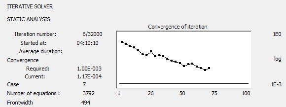

Iterative Method calculations
The calculations dialog for the Iterative method shows the convergence process of the iterative method if the user defined level of accuracy is achieved, or if the process is divergent.
- Number of the current iteration / maximum number of iterations.
- Required accuracy.
- Accuracy of the current iteration.
- Number of equations.
- Frontwidth.
