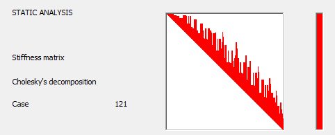

The calculations dialog for the Skyline method shows the following phases:
    • Model reduction (renumbering of nodes and elements)
    • Definition of the stiffness matrix for individual structure elements
    • Matrix decomposition (Cholesky decomposition)
    • Number of blocks.
    • Division of the stiffness matrix. A part of the matrix is saved on the disk, slowing calculations.
    • Problem solving for successive load cases.
