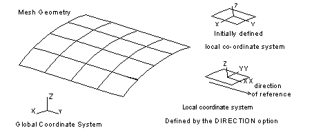

The X and Y axes are local and defined using the Direction option on the Detailed tab. This defines the direction of the main local coordinate system which will be used (x axis). The results values for all elements are calculated to this rotated coordinate system. When selecting the results for planar FE, the direction may be defined by entering any vector defining the main direction. The selected vector is then projected onto an element which in the end defines the positioning of the local x-axis. The main vector can not be perpendicular to the element (parallel to the local element z axis). If this direction is selected, all results will equal zero.
Typically all elements are located on a cylindrical surface. Initially local x axes are parallel to the global X axis. These axes are redefined when using the main (reference) direction which is parallel to the global Y axis.

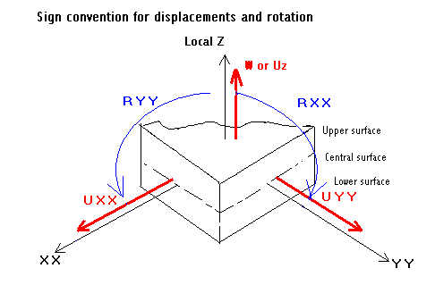

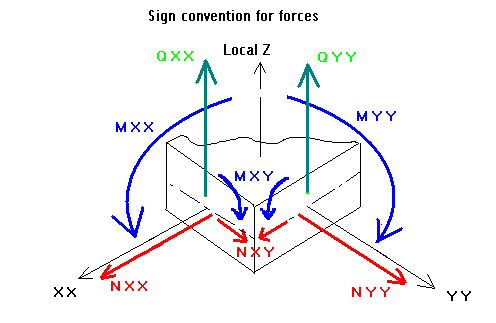

The following define the sign convention applied to forces for planar finite elements.
