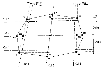

Values of reduced forces should be obtained for 6 cross-sections described as follows.
Position of allowable cross-sections for reduced results
In order for cross-sections 1, 3, 4 and 6 to be correctly defined within panels (no defined coordinates), move the cross-sections by the Delta value with respect to the main panel nodes N1, N2, N3 and N3. The delta value equals the tolerance value applied in the generation of the calculation model.
The following point positioning is obtained.
Point M1 is the center of segment N1-N2.
Point M2 is the center of segment N2-N3.
Point M3 is the center of segment N3-N4.
Point M4 is the center of segment N4-N1.
Point C is the center of segment M1-M3 or is the center of segment M2-M3
Point M1' is the point of intersection between the line (M1,M3) and the panel edge.
Point M2' is the point of intersection between the line (M2,M4) and the panel edge.
Point M3' is the point of intersection between the line (M1,M3) and the panel edge.
Point M4' is the point of intersection between the line (M2,M4) and the panel edge.

Points Po and Pe will be identical with Points N1 and N4 for cross-section 1.
Points Po and Pe will be identical with Points N2 and N3 for cross-section 3.
Points Po and Pe will be identical with Points N1 and N2 for cross-section 4.
Points Po and Pe will be identical with Points N3 and N4 for cross-section 6.
Points Po and Pe will be identical with Points M1' and M3' for cross-section 2.
Points Po and Pe will be identical with Points M2' and M4' for cross-section 5.
