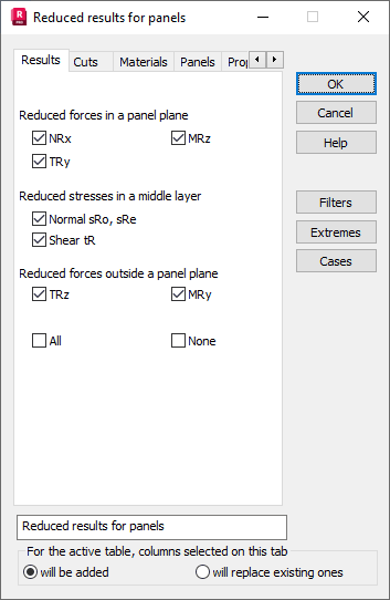

Select the Results tab in the Columns dialog to select quantities for presentation.
The header of the first column contains, depending on the indicated load case, the following loads.
- Panel / Cut / Case
- Panel / Cut / Case / Component
- Panel / Cut / Case / Mode
Cut description is carried out with respect to the numbers of the main panel nodes: N1, N2, N3 and N4.
Cuts 1, 3, 4 and 6 receive the following descriptions: N1-N4, N2-N3, N1-N2 and N3-N4.
Cuts 2 and 5 receive the following descriptions: N1~N2-N3~N4 and N1~N4-N2~N3.
