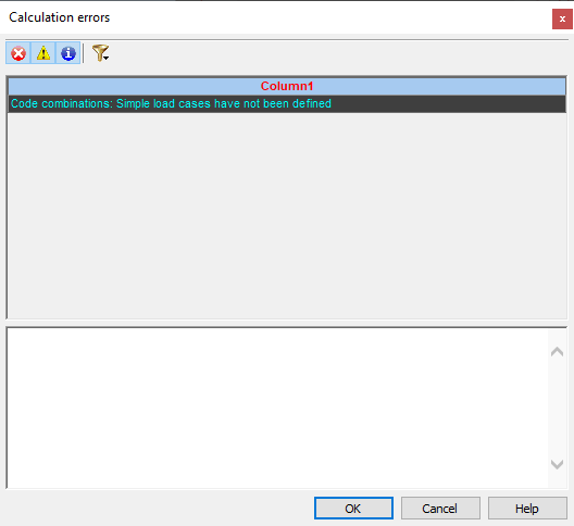

Code combinations: Relations have not been defined
Code combinations: Load combinations have not been generated
Code combinations: Simple loads have not been defined
