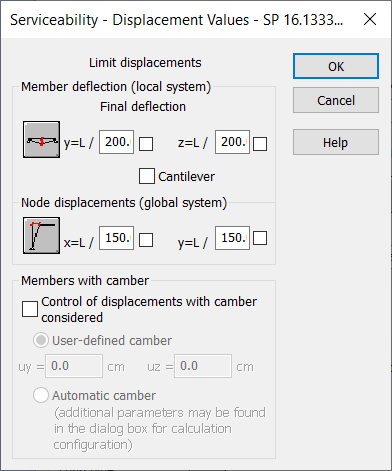

Member Definition - Serviceability (Displacements)
Use this dialog to define additional parameters determining the limit displacement values.
Access
  • Click Service in the Member Definitions - Parameters dialog.
Dialog elements
Member deflection (local system)
Enter the member deflections in the Y and Z directions, and specify if the member is a cantilever.
Node displacements (global system)
Specify the node displacements in the X and Y directions.
Members with camber
Control of displacements with camber considered
Select this option to take into account the camber value during the member verification or design.
User-defined camber
Specify the uy and uz values for the camber.
Automatic camber
Uses the camber value calculated by the program.
Note: The program uses the dead loads to calculate the automatic camber value.
