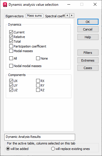

Select the Mass Sums tab in the Table Columns dialog to select mass sum parameters for presentation.
The following values may be selected for presentation.
  • Current. After selecting the appropriate direction of the degree of freedom, (UX, UY, UZ, RX, RY, RZ) columns in which the percentage of masses included in the current eigenmode will appear in the table.
  • Relative. After selecting the appropriate direction of the degree of freedom, (UX, UY, UZ, RX, RY, RZ) columns in which the percentage of masses from 1 to the current eigenmode will appear in the table.
  • Total. After selecting the appropriate direction of the degree of freedom, (UX, UY, UZ, RX, RY, RZ) columns in which the total sum of masses included will appear in the table.
  • Coefficient of participation. After selecting the appropriate direction of the degree of freedom, (UX, UY, UZ, RX, RY, RZ) columns in which the modal coefficients of participation for each degree of freedom will appear in the table.
  • Components. Depending on the selection made in the dialog, columns in which the UX, UY, UZ, RX, RY or RZ components of current mass, total mass, modal coefficients of participation will appear in the table.
