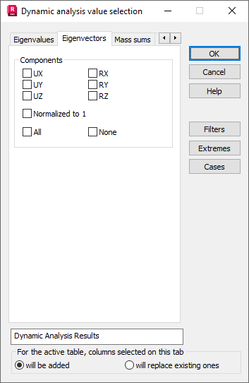

Select the Eigenvector tab in the Table Columns dialog to select parameters for eigenvector presentation.
The following values may be selected.
  • UX, UY, UZ, RX, RY or RZ. If selected, they add columns containing the UX, UY, UZ, RX, RY or RZ components of eigenvectors, respectively, obtained during calculations.
  • Normalized to 1. The values of vector components will be calculated in such a way that the length of the eigenvector will be equal to 1.
