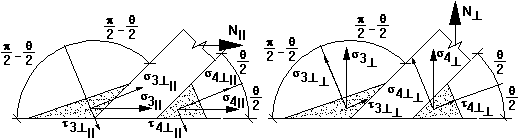

Distribution of forces in welds due to a load parallel to the chord
Distribution of forces in welds due to a load perpendicular to the chord

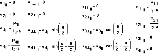

Distribution of stresses in longitudinal welds
Distribution of stresses in transversal welds

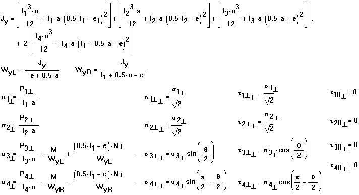

Formulas for calculation of individual stress components
Formulas for resultant stresses in welds (longitudinal 1, longitudinal 2, transversal internal 3, transversal external 4)
