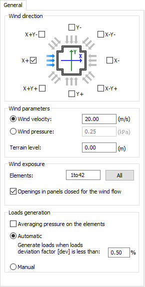

General tab
Wind direction
Shows the list of wind directions according to the global coordinate system. By default, the X+ direction is selected.
Wind parameters
Specify the wind velocity, pressure, and ground level.
Wind exposure
Specify which elements are exposed to the wind, and indicate if the openings in the panels must be considered as closed or not.
Loads generation
Select Averaging pressure on the elements to apply the wind pressure as an average load on panels. Otherwise, the load will be more detailed and applied over the finite mesh of the panel.
Note: Loads generated onto columns, beams, and claddings (panels without stiffness used for load distribution to members) will remain uniform with averaged values.
Specify how you want to generate the wind loads:
  • Automatically with a convergence threshold for the deviation factor
  • Manually

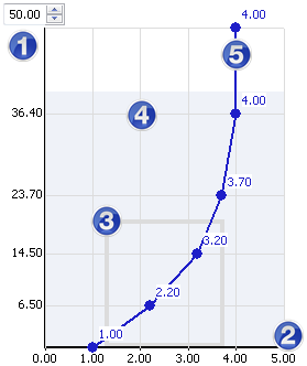

Wind Profile tab
Use the Wind Profile tab to create a variable wind profile.
Note: The wind loads created using a custom wind profile are tagged as "variable" in the list of loads, e.g. "Wind Simulation X+ 20m/s (variable)".
Wind profile: Graphic elements
To create a wind profile, click anywhere on the graphic curve to create a point, and then drag this point to the required coefficient.
  1. Height
    Allows you to adjust the wind profile curve, or to expand it beyond the virtual wind tunnel range.
    This option is useful if you want to save a wind profile in order to apply it to other buildings.
  2. Velocity factor
    The multiplying factor which refers to the velocity of the base wind.
  3. Building outline
    Shows a summary representation of the building size.
  4. Wind tunnel (light blue area)
    Graphic representation of the virtual wind tunnel.
    Note: The size of the virtual wind tunnel is set automatically, based on the size of the building. If the wind profile is bigger than the size of the wind tunnel, the simulation takes into account the wind loads in the inner limits of the wind tunnel only.
  5. Wind curve
    Curve representing a wind profile in a virtual wind tunnel.
Name
Enter a Name for the wind profile that you want to save.
Once saved, the profile name is added to the drop down list which allows you to select a saved profile.
<Load Wind Profile>
Contains the list of wind profiles if you created any.
Reset
Restores the default wind profile.
Loads generation process
When the analysis is started, the following elements display.
Display
Click Pressure on elements to display the pressure scale on the faces of the model.
Click Pressure scale to change the color palette of the scale.
