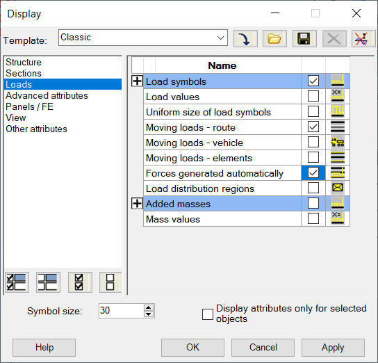

You can also visualize the pressure load distribution for finite elements (if not, the averaged method is used). Click View > Display and choose Loads on the left panel. Select Forces generated automatically in the display table.
If prompted, run a model generation in order to create the finite element mesh and apply the loads.
