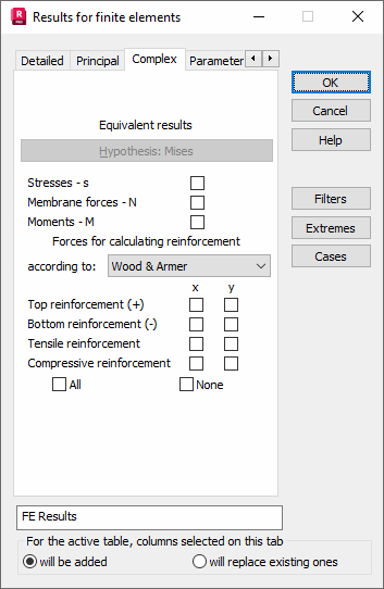

Complex Results
Select the Complex tab in the Columns dialog to select complex results for presentation.
The following reduced values may be selected.
  • Stresses S - Adds a column for reduced stresses S chosen during structure analysis for individual planar FE.
  • Membrane forces N - Adds a column for reduced moments M chosen during structure analysis.
  • Moments M - Adds a column for reduced membrane forces N chosen during structure analysis for individual planar FE.
The Hypothesis button (to select the hypothesis according to which reduced values are calculated) is not currently available.
The list of reinforcement calculation methods include Wood&Armer and NEN.
You can choose internal forces (design moments Mxx and Myy or membrane forces Nxx and Nyy) obtained by applying a selected method of reinforcement calculation. These calculate top reinforcement, bottom reinforcement, compressive reinforcement and tensile reinforcement.
Note two buttons at the bottom of the dialog.
  • All - Selects all values from this tab for presentation.
  • None - Deselects all values from this tab.
