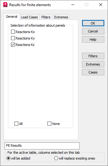

Select the General tab in the Table Columns dialog to select general parameters for presentation.
In Selection of information about panels, the following panel values may be selected.
- Reactions KZ - A value of the KZ reaction is displayed. It is represented as a sum (integral) of the elastic ground reaction for a panel on the elastic ground. The value is constant for a whole panel.
