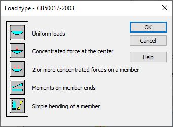

Share Email Facebook Twitter LinkedIn Load Type The dialog box below enables definition of a load pattern for the analyzed beam. The information about the loading method is used in calculation of a value of the lateral buckling coefficient φ b according to Appendix 1 to the code. Parent topic: Steel Code GB50017-2003 (China)
