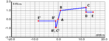

Longitudinal Force
Hinge parameters:
  • The slope between points B and C is 3% strain hardening.
  • Initial compression slope is the same as the initial tension slope.
  • Points C, D, and E based on FEMA 273 (table 5.8, Braces in tension).
  • Points C', D', and E' based on FEMA 273 (table 5.8, Braces in compression, Item c).
