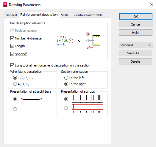

Use this dialog to setup how you present the information on working drawings prepared for RC structure elements such as beams, columns, and foundations.
To make your drawing presentation settings:
  1. Click the Analysis tab and select Drawing Parameters... from the drop-down list.
  2. In the Drawing Parameters dialog, select the Reinforcement description tab and set your preferences.
