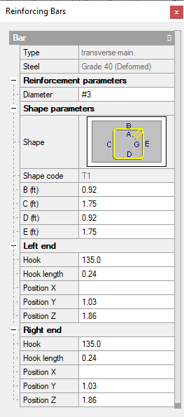

If no reinforcing bar has been selected in the graphical viewer or the table of reinforcing bars, the dialog box will remain empty. If the user selects a reinforcing bar, the dialog box will consist of the three tabs:
  • Global
  • Shape parameters
  • Position.
The Global tab presents basic data concerning a selected reinforcing bar, namely: steel type, code symbol, steel grade, reinforcing bar diameter and shape. The Shape parameters tab contains bar-shape symbol and bar component lengths. The Position tab contains the coordinates of the beginning of the reinforcing bar (this tab allows changing the reference point of coordinates).

The dialog box may serve to change an already defined reinforcement. If the user changes parameters of a selected reinforcing bar in the above-described dialog box and presses the Apply button, the changes in the reinforcing bar parameters will be included in the editing viewer and the reinforcement table.
The "<<" and ">>" buttons allow the user to present the parameters of, respectively, the former or the following reinforcing bar in the list presented in the reinforcement table.
