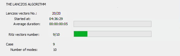

Calculations
The calculations dialog for the Lanczos method shows the following phases:
  • Number of the current iteration / maximum number of iterations.
  • Required accuracy (tolerance).
  • Accuracy of the current iteration.
  • Number of required modes.
