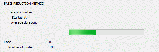

The calculations dialog for the Basis Reduction method shows the following phases:
