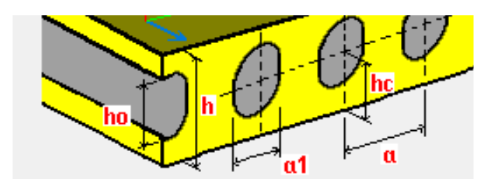

Hollow slab
ha = h - h1 - h2 stiffener height
Membrane stiffness:
s1 = a*h1, s2 = a*h2, s0 = (h-h1-h2)*a-(3,14*a1*a1/4+c*a1)
D_XXXX = E/xv*(s1+s2+s0)/a
D_YYYY = E/xv *(h1+h2)
D_XXYY = v*E/xv *(h1+h2)
D_XYXY = G*(h1+h2)
D_XXXY = 0
D_YYXY = 0
Bending stiffness:
hz1 = h1 + a1/12, hz2 = h2 + a1/12, xv = 1 - v*v, r = a1/2
c=h0-a1
Dyyyy= E*a/((a-a1)/(InertiaIsec(1/xv,0,h,h1,h2) + a1/InertiaIsec(1/xv,0,h,hz1,hz2))
Iy = InertiaIsec(a/xv,a-a1,h,h1,h2) + 4*(0,00755*r*r*r*r + 0,2146*r*r*(c/2+0,7766*r)*(c/2+0,7766*r))
If the stiffness of bending in Y direction was disregarded, then Dyyyy = 1,0*e-4*Dyyyy
If not, then Dyyyy = Dyyyy
K_XXXX = E*Iy/a
K_YYYY = Dyyyy
K_XXYY = v*Dyyyy
K_XYXY = (1-v)/2*Dyyyy
K_XXXY = 0
K_YYXY = 0
Shear stiffness:
H_YY = 5/6*G*(h1+h2)
H_XY = 0
H_XX = (5/6)*G*((a-a1) * h1p2 + a1 * ha) * (1/a)
Where
h - floor thickness
h1 - lower plate thickness
h2 - upper plate thickness
a - rib spacing
a1 - opening width
ha = h - h1 - h2 - stiffener height
