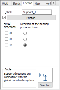

When the Friction tab is selected from the Support Definition dialog, the following dialog displays.
The options on this tab lets you define a support type that considers friction. When the check box next to the Friction button is selected (),the Direction of the bearing pressure force options are available. Clicking Friction opens another dialog for defining following values:
