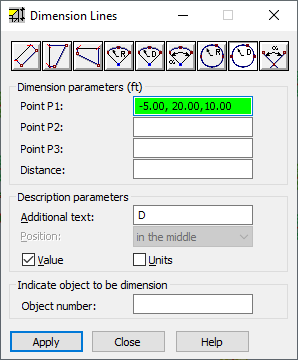

Open the Dimension Lines dialog, which defines dimension lines for a structure, using either method:
  • Click Tools menu Dimension Lines.
  • Click .
At the top of the dialog, the following options are available for selecting dimension lines. You can define a dimension line graphically or by entering values in the appropriate fields of the dialog.
Segment dimension line (Line - parallel)
A dimension line is defined as perpendicular to a segment. The following is specified for the dimension line:
Beginning - The beginning point of a dimension line.
End - The end point of a dimension line.
Distance - The dimension line distance to a dimensioned segment.
Segment dimension line (Line - vertical)
A dimension line is defined as vertical to a segment. The following is specified for the dimension line:
Distance - The dimension line distance to the beginning point of a dimensioned segment.
Segment dimension line (Line - horizontal)
A dimension line is defined as horizontal to a segment. The following is specified for the dimension line:
Arc dimension line (Arc - radius)
A dimension line can be defined for an arc by specifying its radius. The following is specified for the dimension line:
Point 1 - A point on an arc.
Point 2 - A point on an arc.
Point 3 - A point on an arc.
These points define the arc, for which a dimension line is defined.
Distance - The line position that defines the arc radius.
Arc dimension line (Arc - diameter)
A dimension line can be defined for an arc by specifying its diameter. The following is specified for the dimension line:
Distance - The line position defines the arc diameter.
Arc dimension line (Arc - angle)
A dimension line can be defined for an arc by specifying its angle. The following is specified for the dimension line:
Distance - The line position defines the arc radius.
Circle dimension line (Circle - radius)
A dimension line can be defined for a circle by specifying its radius. The following is specified for the dimension line:
Point 1 - A point on a circle.
Point 2 - A point on a circle.
Point 3 - A point on a circle.
These points define the circle, for which a dimension line is defined.
Distance - The line position defines a circle radius.
Circle dimension line (Circle -diameter)
A dimension line can be defined for a circle by specifying its diameter. The following is specified for the dimension line:
Distance - The line position defines a circle diameter.
The Object number (Indicate object to be dimensioned) field is at the bottom of the dialog. In this field you can specify an object number that is dimensioned. A dimension line is linked to the dimensioned object.
When the Line type (see table above) and Description parameters (Additional Text, Position, Value and Units) options are selected, you can define a dimension line in a structure can using one of the following methods:
  • Enter the point coordinates of a dimensioned object in the dialog, and enter the distance of the line to an object defined in the structure. Click Apply.
  • Click the Beginning or Point 1 field, move the cursor to the drawing area and click the beginning and the successive points that define the dimensioned object. Specify the distance between the dimensioned object and the line.
  • A combination of the previous methods.
