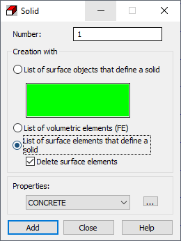

To define a solid, you must specify:
  1. Solid number.
  2. Solid edges (contours) in any of 3 ways:
    • Indicate surface objects that determine solid volume.
    • Define a list of volumetric finite elements.
    • Define a list of surface elements (such as, after loading a DXF file with structure geometry) creating a solid contour. If the Delete surface elements option is selected, the surface elements defining a solid contour are deleted from the volumetric structure.
  3. Solid properties.
Note: At the bottom of the dialog, the button is located. Clicking it opens the Definition of solid properties dialog in which you can define solid physical properties. . The defined types of solid properties are added to the list of active properties.
