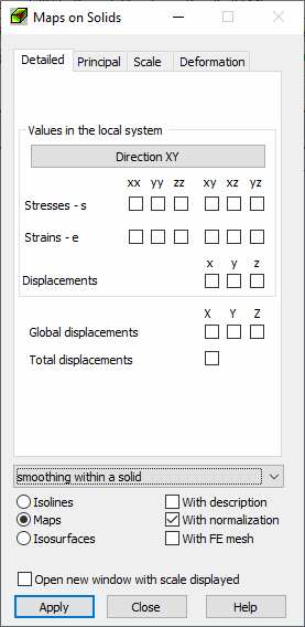

    Detailed
    Select the Detailed tab in the Maps on Solids dialog to select detailed information for presentation.
    Stresses, strains and displacements can be selected for presentation. Only one of the results can be selected on all tabs.
    Results are presented in the local coordinate system, thus there is a possibility to select a local system direction. Click Direction to open the Selection of Direction dialog and select the vectors and node defining the local coordinate system.
