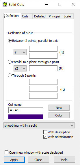

Solid Cuts is used for presenting maps on cuts through solids.
Results are shown on the cut surface.
The dialog consists of five tabs:
Note: The last three tabs are similar to those in the Maps on Solids dialog. Additionally, the Detailed tab contains the Internal forces in the table option.

The lower dialog contains the following additional options.
  • With description. Presents descriptions for isolines or displays values at the element center; for isosurfaces it should be a single value for a given isosurface.
  • With normalization. Automatic calculation of extreme values for the scale.
  • Open new window with scale displayed. Opens a new window containing selected elements and objects. The window is split into a view and a scale legend.
