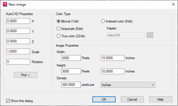

Creating a New Image
You can create a new blank image to contain an image created by editing another image or merging two or more images. To create a new image, you first define an image frame, then set properties in the New Image dialog box. For more information, see Creating a New Image.
After you have created a new image, you must save it to establish a link between the drawing and the image file. To define the properties for more than one new image, use the New Image tab on the AutoCAD Raster Design Options dialog box.
