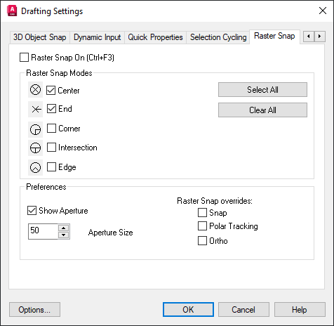

When raster snapping is on (active), a snap window is displayed around the AutoCAD cursor. The snap window displays the crosshairs over points to which you can snap. You can select one or more snap modes to control whether the cursor snaps to endpoints, corners, and other points.
You can toggle Raster Snap on and off from the Snap panel on the Raster Tools tab of the ribbon.
To access the Raster Snap options
- Do any of the following:
- On the ribbon, click
Raster Tools tab
Snap panel
Dialog box launcher (
- At the Command prompt, enter isnap.
