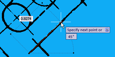

Vectorization tools can verify and adjust the dimensions of the vector entities you draw, which is important if the raster image you are vectorizing is not completely accurate. For example, after you vectorize a line segment, you can check the line length and angle. If they are incorrect, change the dimensions before you create the next line. These review and edit operations can be much easier if you enable AutoCAD’s Dynamic Input while vectorizing.
Dynamic input prompts during vectorization
Dynamic Input shows prompts in convenient locations. The figure shows an example of prompts that display the line length and angle as you move the cursor. You can also enter a numeric value for the line length.
