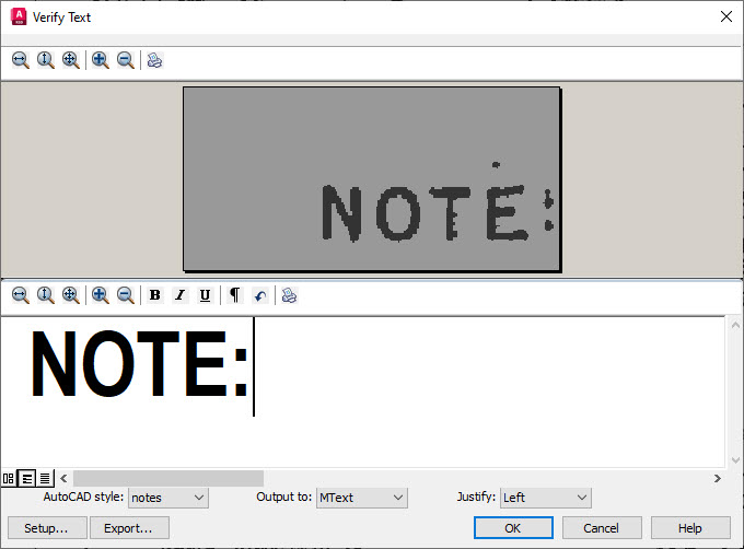

Verify Text/Table Dialog Box
Use this dialog box in text recognition operations to examine the source text and control the format of the output text. The dialog is called Verify Text or Verify Table, depending on which option was selected.
Viewer Pane Controls
Zooms in so the text fills the width of the view window and there is no horizontal scroll bar.
Zooms in so the text fills the height of the view window and there is no vertical scroll bar.
Zooms in so the text is completely contained in the corresponding pane at the greatest zoom possible.
Zooms in to expand the recognized raster text in the pane by a factor of 25%. The text may be zoomed in to a maximum factor of 300%.
Zooms out to shrink the recognized raster text in the pane by a factor of 25%. The raster may be zoomed out to a maximum factor of 25%.
Prints the data from the pane.
Editor Pane Controls
Zooms in so the text fills the height of the pane and there is no vertical scroll bar.
Zooms in so the text is completely contained in the pane at the greatest zoom possible.
Applies bold formatting to the selected text in the Editor pane.
Applies italic formatting to the selected text in the Editor pane.
Applies underline formatting to the selected text in the Editor pane.
Specifies the display of non-printing characters such as Tab and Space.
Reverses the last editing action.
Recognition and Output Controls
Suspect Word
Displays the unrecognized word.
Rejected Character
Displays unrecognized characters or artifacts.
Change To
Specifies a replacement for the suspect word or rejected character from the drop-down list.
Find Next
Moves to the next suspect word or rejected character.
Replace
Replaces the suspect word or rejected character with the selection in the Change To box.
Add To Dictionary
Adds the suspect word or rejected character to the to the Recognition dictionary.
AutoCAD Style
Specifies an AutoCAD style.
Output To
Specifies the conversion of the raster text as either AutoCAD Text or AutoCAD MText.
Justify
Specifies the text alignment as right, left, or center.
Setup
Displays the Text Recognition Setup dialog box.
Export
Exports the text in the Edit pane for use in another application.
