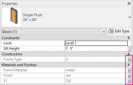

Assign Keys to Elements
When a key is applied to an element, properties assigned by the key become read-only in the Properties palette. Parameter values aligned with the key value display "=" to the right of the value. Parameter values that cannot be aligned with the key value display "≠".
