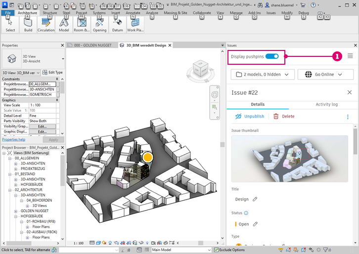

Display pushpins in your model to identify when issues are.
When working with Revit Issues add-in, select Display pushpins
to highlight the area in your model related to the issue.
Pushpins are visible for 3D issues, 2D issues and drawing sheets.
